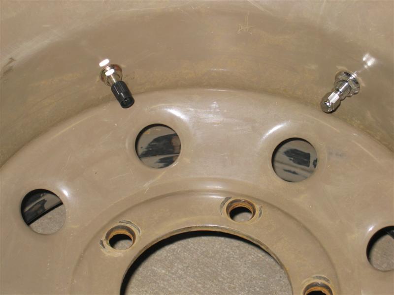

Those of you that have seen me air down know I had 2 valve stems already. The beadlock has a special flap with thick tongues to allow their special valve stem to air up and down the tire. The inner tube would press against my other valve stem rendering it useless, so I decide it would be best to get rid of it. I bent an aluminum plate to the rim's form and used RTV to stick it down. Bungee cords kept it tight overnight.
And to replace my quick air down coreless valve stem, I purchased some Staun tire deflators. It won't be as fast but it will be easier, plus it's a new offroad gadget :D

About the valve stems, you need to replace the stock stem with Staun's, it has a slit in the back to allow air to pass under the inner tube.
And here's what it looks like on the other side if you stick with Staun's pieces.
On the left is the inner tube valve body and a plastic cap with a valve stem remover. On the right is the shiny new tire valve. I decide to replace the tire valve cap with my No Loss Tire Caps from Extreme Outback since it has a seal and a tether. And I put the Staun metal one on the inner tube since it too has an added seal.
