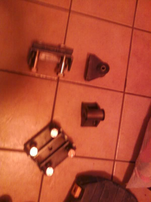

Spare parts:

U-bolt eliminators for the front, and the rear bushing/bracket for the front leafs.
