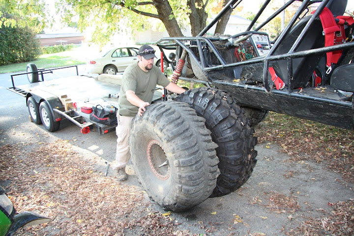

Next to the warn out 44" bogger.

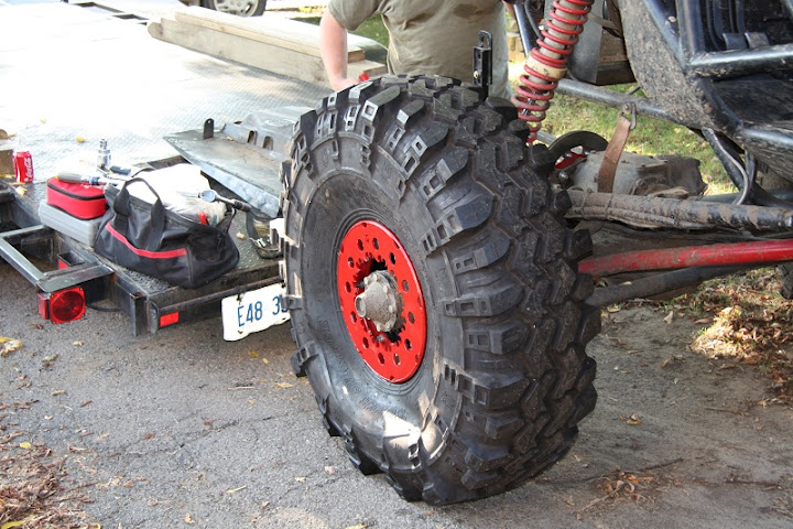

Front mounted, 0 psi:
Love the wheels, hate the options I chose. I keep meaning to send TWF a note not to sell the wicked ring to any rockwell guy getting 4" backspacing. If you notice, there is not very much room between the ring and the hub. There is barely enough room to get your hand between them... the socket had to be fed in from the backside of the wheel in order to mount the wheels. I will be getting the rings cut in the spring. Oh well.

That really sucks about the outers blocking access to the nuts... I can't believe someone didn't already tell TWF about that.

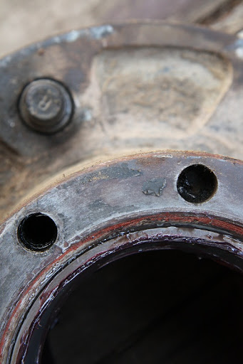

Discovered an interesting tidbit yesterday. My wheels are not clearing the shoulder of the wheel studs... so the wheels are not mounting flush against the hub flange and are actually about 1/4" out, resting on the studs. I have an email into TWF with a WTF question. Not sure at this point if I have an oddball set of studs or if they cut the centers wrong.

Is there anything missing from your hub area that would make up that shoulder that the rim isn't clearing? Like a drum or something?
bradleyfitz
No, I am not missing anything. I'm working with Andy to try to figure out what is going on here. He says they have always machined the holes to 0.800, which is what my wheels are. The stud diameter at the knurl / shoulder is about 0.9... so far Andy has managed to dig up a picture of TWO different types of rockwell studs. One has a much shorter shoulder than the other. We have also seen a hub where the flange also appears to be thicker than mine.

Sounds like swapping studs might be the fix, no? Or is TWF willing to remachine the wheels (shipping/down time would suck).
bradleyfitz
Right now we are trying to figure out the discrepancies. One of three things will come out of this, I am sure. I will either replace all the studs with the shorter version, drill / remachine the wheels to accept the shoulder, or have Mike cut me a spacer. I was able to find a corresponding Napa part number for rockwell wheel studs, but since there are two stud types, I am not sure which one it is. I will be calling Keith later and hopefully the book will have details. Online prices for studs are in the $5 range, so replacing all of them with a shorter wheel stud would unfortunately be upwards of $150.

Take all studs out, bring them to General grinding and ask them to take the excess shoulder down. plain and simple, and proly cheapest.
bradleyfitz
I considered that, but I was concerned with two things.
1) weakening the stud.
2) the overall shoulder length before the threads is likely going to be too long. It may not be, I would have to measure carefully
