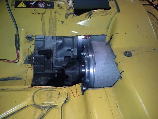

After test setting the tub, it was obvious i was going to need a BL.. Installed the 1" BL and STILL could not clear the ATLAS. So, in a moment of stupor i cut into the tub floor!
It fits now.
